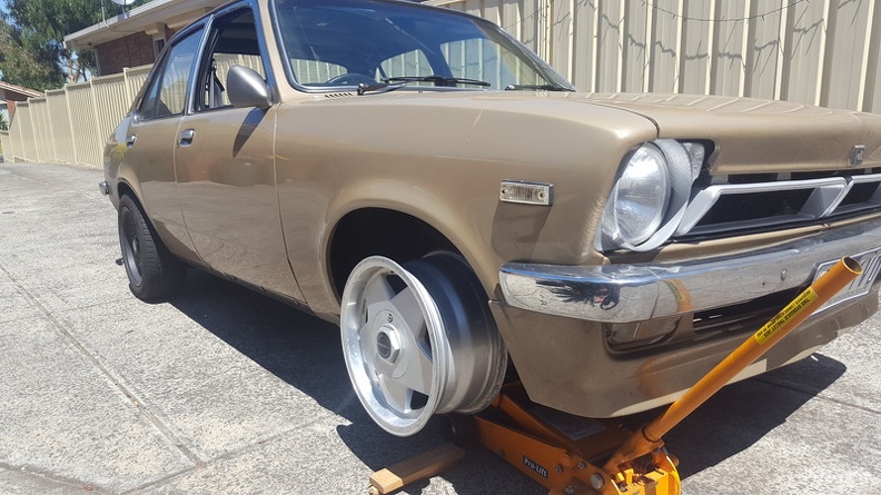

Third issue is the wheels. ET15 to ET25/15x7 is supposed to fit easily and be pretty much the perfect offset for a Gemini - the BBS reps are 15x7 / ET20 so should be good. Except i really dont see how im going to avoid smashing that guard on full lock over a bump, in particular the right hand side which is clearly a non-genuine guard. I pulled the arch out by hand a bit and gained a fraction more clearance, but its still eye wateringly close. It doesnt scrape/touch/rub with the wheel dead straight over bumps and at speed. Low speed/at lock seems to be ok. BUT. Full lock at ride height and theres pretty much bees-dick clearance between top of tyre and gaurd. Have no idea why it sits so wide/so little clearance. Are the wheels wrong? Are they actually 15x7.5? Will i kill a quarter panel and 11ty kittens by hitting a bump mid-corner? Its actually rubbed a few times when ive turned quick-ish through a LH corner :confused:
This also creates an issue for brakes. I have a complete VT 300mm front end kit ready to go but unless i buy wheels with an offset of ET35-40 I cant use these as they increase the track 10mm PER SIDE, which would effectively make an ET20 an ET10. Not going to work. Car is already at max-camber too [around -2.5deg] so that wont fix things either. Heres what i think about ET35-ET40 offset wheels:
So either theres something wrong with my car [possible, shes had a hard life], i need narrower wheels [gay], FWD offset wheels [even gayer - all the wheels i have are ET20-25] or different brakes. I think its going to require a rethink and a completely different set of brakes. Rear brakes will be VL-VN discs off a 28spline borgy including matching calipers, which push the track out +5mm per side. Not a problem because the wheels actually fit like they are meant to. and dont touch/rub/come anywhere close.

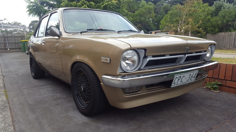

So, its been a while. Last real installment was at the start of December 2016.....thats almost 6 months ago! Time flys it seems. Truth is i havent really done anything to the car apart from drive the f*#k out of it, so as a result i havent had anything to really post about. And when i say drive the f*#k out of it i mean it - ive racked up around 10500km since November. Its currently my daily driver while my wife drives the ute around until i get her a new car.
Last time around I'd just bought the Borbets. Did a test fit just before christmas, they sit ok - still 50/50 on them staying on the car long term though, but i'll reserve judgement until they are painted and on the car. Also considering getting the non-hex style center caps as well. Started to strip them down which is where ive discovered that this seriously is the worst job in the world. Fun fact - borbets have around 11ty layers of paint which seem to be 900mm thick. So far ive started two and given up for the moment :rotflol:
To be honest, i think they need to be painted more of a charcoal colour to look right - the silver is too light and doesnt stand out enough. Problem ive got is i cbf painting it one colour, then taking one look and going nah - looks s*#t, strip it down again. f*#k that!

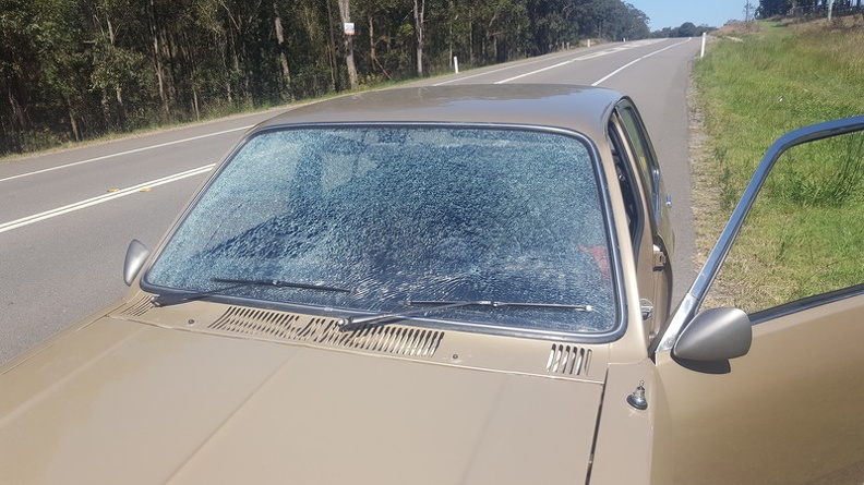

***Happened about 40km out from the hunter valley, mid day, peak heat. Coming up behind an RV going up a hill, the bloke did the right thing and moved over to let cars through. f*$kwit up front couldnt work out what the hell they were doing and after hesitating for an eternity went around the RV. By the time the time this had all happened, the road was now downhill and RV was now doing the same speed as us [just on 100kmh] and coming up to a corner, so i gave him a flash to let him merge back over. Van starts moving over...
Stone/Rock/solid object, meet Windscreen. Windscreen...well, c*#nts f*#cked. f*#k. RV had flicked up a stone or whatever and launched it into the screen. Saw something small flying towards the screen and heard it hit the screen and then suddenly everything went white. Mrs screamed and im just like f*#k, this is going to be fun. Silver lining was I got a good look at the road before the rv moved over so i knew it was straight until corner at bottom of the hill, so i had to basically look at the white reflector posts out the passenger window and hope i could stop without hitting something. To be fair, not really the cars fault, but it just HAD to happen to this car didnt it. Which brings us to the next problem; remember when i said our families thought we were both crazy? Well....that might be because we didnt have any road side assistance/coverage.....
Ended up having to kick/punch/remove the windscreen from the car, before doing the next 40km with no windscreen....boy that was fun. Big thanks to NSW highway patrol who stopped to see if we were ok. Actual thanks/no sarcasm to old mate in the Golf who stopped to see if we were ok/had phone coverage/had water etc. Champion.
Rest of the trip was fortunately uneventful, and at least we lived to tell the tale i guess.

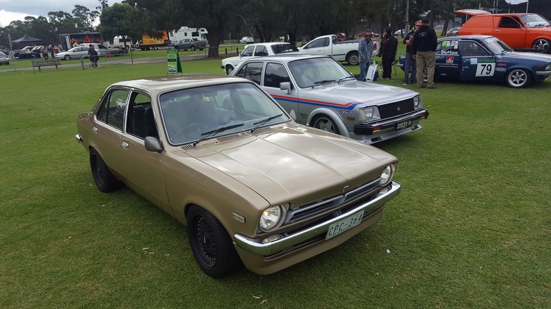

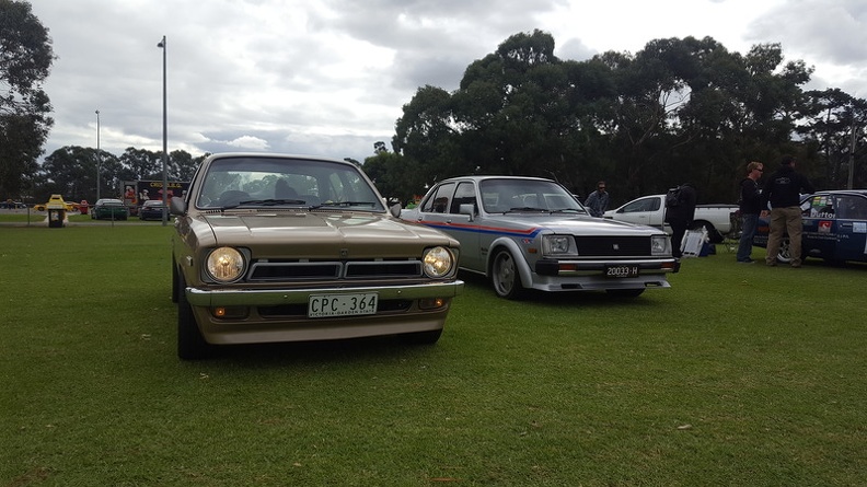

33 cars at first meet point. PFer no13_CoupForgettobringmyfuckinggoodcameraeverywhere car on the left.
Congo line at start of epic run through hills lead by NSW state rally champ, NFI why my Mrs is doing the YMCA in the middle of my photo. Few soft cocks complained ohhh its too long and too hard on the cars. f*#k off, i loved it. Towards the end there were a few of us [about 6 cars or so] running pretty hard, nose to tail. Good fun.
Lunch stop at Wisemans Ferry. Another PF-ers car to right of screen.
